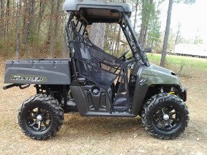

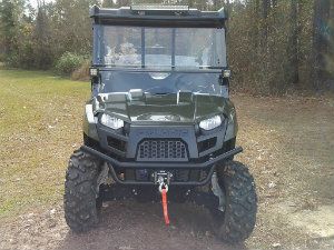

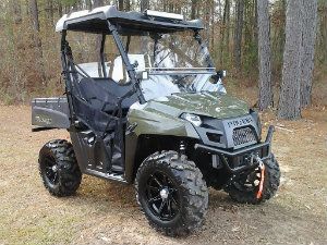

    Heat is not a problem for my 500 either. I tend to do a lot of slow riding, most of the time with some type of load in the bed. Im not sure about the 800 mid, someone will add comments about it though.
    2011 500 EFI
    3000 lb winch
    SS wheels
    28" Zillas
    Backwoods armor Arched A arms front and rear
    2" highlifter
    Lock and ride roof
    Custom stereo
