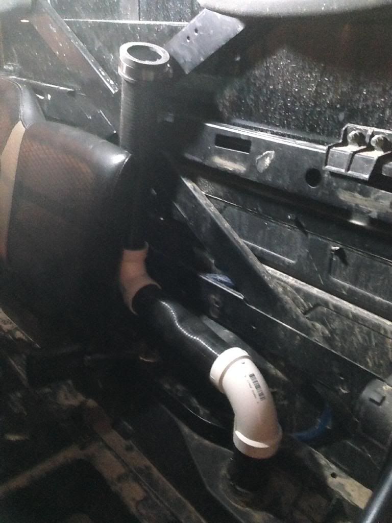

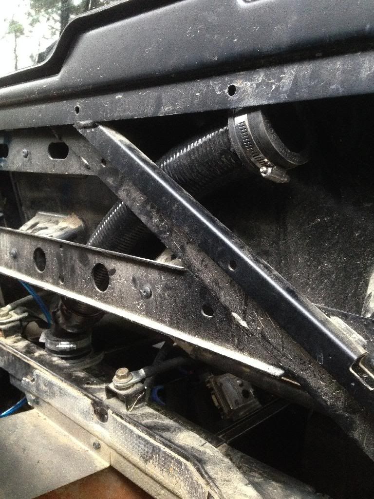

    It can be very easily (and cheaply) done yourself. I have the sliding rear glass, but I didn't want snorkels permanently hanging out. I'd rather have mine routed inside the cab, where they'll draw cleaner air (not much cleaner, but a little anyways). I used 2" black flex pvc, with standard fittings, and hydrophobic pre-filter material over the intake ends. I'll likely re-route them up a little higher, but I was just trying to get these done in time for a ride I was going on at the time. The clutch intake is only routed just below the top of the seat, but at least it won't take on water from the factory side vents. The flex pvc is able to be heated and shaped, so as to provide clearance in tight spots. Used 1/4" & 5/16" ID fuel tubing to extend the breather tubes for diffs and fuel tank. Sealed the inner clutch cover as well, with RTV black. Not a crew, but it might give some folks a few ideas.

    Looks good, any extra noise in cab? How did you run the clutch out put hose. ? Can u post a pic . Thanks for the idea's

    Thanks. There isn't really that much extra noise in the cab. Just a slight "suction" noise from the engine intake. However, as it is now, the engine intake is pretty close to driver's seat. I imagine if I extend it closer to the roof, it might be less noticeable. I haven't noticed any additional noise from the clutch intake. I'll try to get a pic of my clutch exhaust when I get home. I did cut one of the lock&ride plugs, but not the bed. I did this, so I could extend the exhaust up between the cab and bed.
