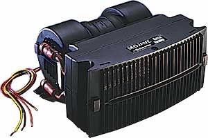

    I have done quite a bit of surfing on the Internet for Heater options for the 2010 Crew. I have found what I believe to be the same integrated heater core/fan blower unit that Polaris is using. It appears to be a Mojave 640 heater. The pic is shown below:
    Mojave 640 Heater Core/Fan Unit Mfg. by Flex-A-Lite
    Pure Polaris Heater Core/Fan Unit
    The Pure Polaris Costs is $549 and the Mojave Cost is $159 through JEGS http://www.jegs.com/p/Flex-a-lite/Fl...61572/10002/-1
    In addition on the Mojave, there is an add-on Plenum Box adds a couple of directional adjustable vents, + a ducting line knockout for adding a defroster vent
    Anyone looking to install the Pure Polaris Heater, may want to check this out, it is significantly cheaper. I would also think that if one was interested in getting the "Adapter Kit" from Polaris, which I am guessing contains the hosing & connections for the machine specific application, they could still buy that for the $99.00 through Polaris.
    I think I am gonna try one of these when the piggy bank allows.

    I really like the find as I am thinking of adding a heater to mine. I thought the polaris unit is suppose to be 28 k btu. the one from jegs is 12k btu.

    That I don't know....I know the one from Polaris has a two speed fan and the one from Flex-A-Lite has a 3 speed fan, so there are some differences. I guess maybe the similarities are only on the outside?
    I have not seen a BTU Rating on the Polaris unit either. It does not list that on the Polaris Website and I cannot find any of the Technical Specs on the Polaris Heater.
    However, I would think that that inside of Cab, at 12K BTU Heater should be sufficient, as there is really not that much area that your heating up.

    I thought they were the same also, ordered the plenum and it would not fit on the polaris heater in my 10 HD., they look the same, but the plenum would not fit over the polaris heater, the polaris is larger, so if any of you get the Mojave I have a plenum I will sell cheap, and if anyone finds a plenum for the polaris heaters please let me know, I would like to be able to direct some air flow on mine.

    That heater is listed as 28K BTU. However, that is not the heater that Polaris is marketing for the new body style Rangers. That heater fits the old body style Rangers, which had more room under the hood.
    The heaters for the New body style Rangers are all "self-contained", meaning there is no ducting for any of the vents. It is the heater core/fan/integrated vent louvers, all in one package that fits under the dash of the ranger.
    The Polaris catalog also shows different heaters available for the older Rangers.
    I guess since Larry G. has one of the new heaters, we could ask if he sees a BTU rating on the heater. He did comment that the Mojave Plenum box would not fit on his heater, even though from pics they look the same.
    I am guessing this is becuase Polaris probably contacted Flex-A-Lite and may have had them design a heater that is very similar to the Mojave, but could have some Polaris Specific features. But from the Pics, they certainly do look the same.
