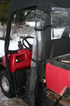

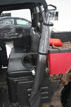

    I forgot to put some picks of the doors rolled back and tucked away withe the provided Velcro straps, they can also be easily zipped off.
    In the end the cab fulfills its purpose and it great protection against the weather. The cab could be a little longer as I had to make an extension for the back to attach. Also I could not put Velcro on the bottom since it was just over an inch short of the floor.
