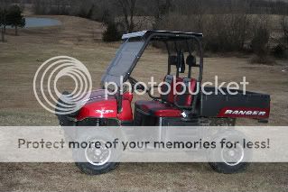

    Got our first real snow yesterday, 8-10". Had a blast playing in the ranger, Only problem was my throttle stuck wide open. I had to take the side off were the cable attaches to the throttle body and manually work it back and forth until it broke free. I do keep this parked in a heated garage and it was taken out twice yesterday. I dont see how water could of entered the cable. Can it just be condensate from temperature changes? Any idea how to cure this? It was only 20 degrees. Thanks
