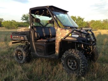

I went with 30 Roctanes and no lift, I used the superatv forward arched a-arms. I had to trim the front bumper but other than that they work great. I think these Roctanes are my favorite tire to date.

Gunguy, could you post a pic of your setup? I wanted 30's but decided on staying 28's because I didn't want to have to crank my shocks all the way up. This is my first sxs, so I'm still trying to figure all this out.

I'm not sure how to upload pics so heres a short video I made a few months ago. This is with the shocks set from the factory and now lift.
