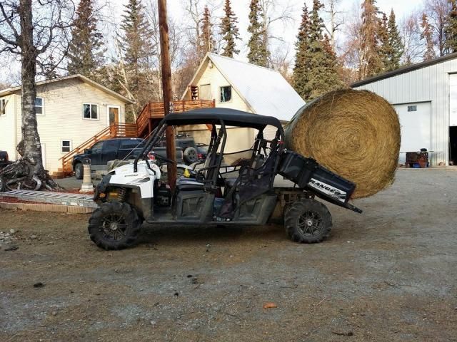

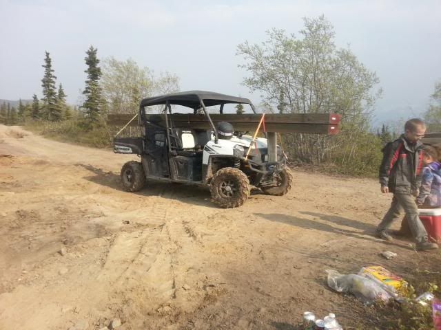

I have been looking at getting a box blade for mine. As well as a rough mower. Been looking into building a pull behind cultivator, seeder and a few other tools. I would love a tractor but I love my ranger and I abuse it when ever I get the chance. Koplin has a 3pt hitch adapter, would be good for any non pto powered class 1 implements.
We are working on upping our 5 acre hobby farm to a 100 acre hobby farm. Will need to buy a tractor, but until then I will keep abusing the poor ranger. Would love to find some pull behind self powered haying equipment.

Wow jmurphy definitely puts his Ranger to WORK!
I think you have more weight on that thing than I'd ever put on it! haha
