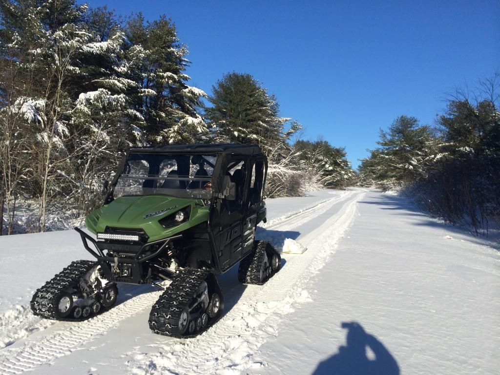

I had a 2010 Ranger 800 xp with the Polaris tracks that did an awesome job of dragging our snowmobile trails. I had a 10inch 6ft long steel I beam I used for breaking and grooming and it worked great! You would be amazed at the amount of snow you can pull behind you with tracks. My buddy had the same machine with the Tatou 4s tracks and it was unstoppable!! I now have a Kawasaki Teryx4 with the Tatou 4s tracks and I have been grooming trails all winter.. The newer Tatou 4s are really incredible on any machine!

Teet... I would only consider the newer version( 2012 and up) of the Camoplast Tatou 4s, or the new Polaris tracks, which are now the Camoplast Tatou 4s......You will not be dissapointed! If you are interested you can go to YOUTUBE and type KAWASKI TERYX 4S TRACKS in the search bar and watch a video we made of the TATOUS in action..we are running in over 3 feet of powder which is the least desiriable of conditions..My buddy has a Rzr 800 with the old style Polaris tracks...I had to break trail while pulling a small drag in order for him to follow and not get stuck.......(sorry..I don't know how to post the link)
