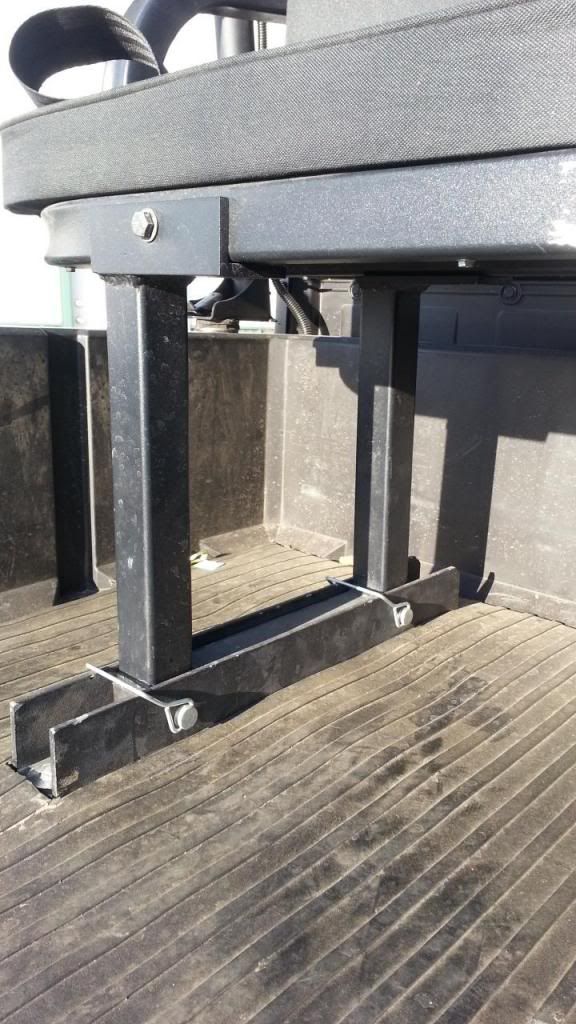

I use a Great Day deluxe rumble seat. Easy to remove/add. Held in place by 4 easy to remove pins. Comes with 2 seat belts.The brackets stay in place. I have a 2" channel iron strip on each side under the box for support. I made my own rubber mat that fits over the bracket to cover the bottom of the bed. The polaris cargo rack is from my prior 800 ranger.
http://www.greatdayinc.com/rumble.htm
I put a piece of OSB mounted on a wood frame over the brackets so I can have a flat bed if need.
I use a double, hitch extender from Harbor Freight. I use this with a step in the hitch and it is easy to climb into the back of the bed over the tailgate.
