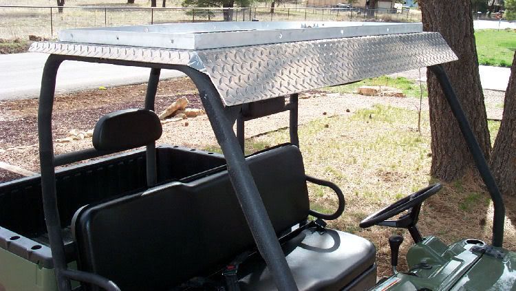

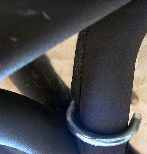

The diamond plate I used is 36 inches by 64 inches by 1/8 inch (11 gauge). The sides and the back have 1.5 inches of material at aproximately a 45 degree angle, the front is 6 inches and the angle matches the front of the cage. My 120 volt welder can't weld that thick of aluminum. So to get the edges to bend I used my 4.5 inch grinder with a metal cutting blade and carefully cut part way through the backside of the diamond plate and bent it down by hand. I then preheated the cuts and welded them, then ground the crappy weld job smooth to make it look nicer. It was the first time I tried to weld aluminum, so it wasn't pretty. To attach it to the roll cage I took 1/4 inch by 2 inch U-bolts and cut one leg off to make J-bolts. I slipped 1/4 inch clear tubing on the four J-bolt so it wouldn't scar up the roll cage, plus I think it stays in place better. I used 1.5 inch water pipe insulation split lengthwise between the roll cage and the diamond plate top and I have no rattles. I also added a rack to the top made of aluminum angle so I can strap things down and haul them up there. I don't remember the exact cost, but I think it was under $100.00, here are a few photos.

"Flagman"........thats the kind of info I was hoping to get started. That is really a great idea on bending the edges. I've been wondering how I was gonna get them bent without a brake? The measurments on the lips are good to know also. It looks really nice!! Thanks for the taking the time to do the right up....................

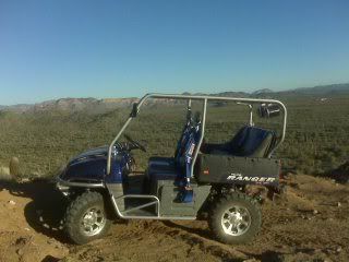

You may be able to see mine on my signature pic. Don't recall the thickness, but plate steel bent at the back, primed, sprayed with bedliner material, and fastened with pop rivots. Been on there for almost 4 years, and only a few tree branch scratches- but strong enough to stand on, and holding up real well.
