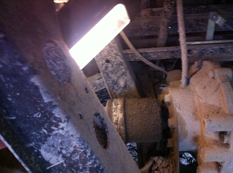

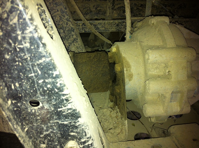

I noticed a slight leak and/or seep out of my rear gearcase this weekend. Anyone else have this issue? Know how to solve it? There must be a seal of some sort in there. Is this a do it yourself repair or bring to the dealer? Its leaking right where the shaft enters the gearcase.
thanks!
few pics here

Seems like they all leak or weep oil a bit. My 2006 did and my 2009 as well. All Rangers I have worked on exhibit the same type left side leak. I changed the seal on a 2006 for a Ranger Buddy, but it still weeps. Didn't help much.

Just pull the axle and change the seal. It's a pretty easy fix. :wink:

Can it be done without tearing down the whole gear box/differential? I looked in the manual last night and I'm not THAT mechanically inclined to tear apart the rear end.

All you have to do is pull the axle and the seal will pop right out and in.
