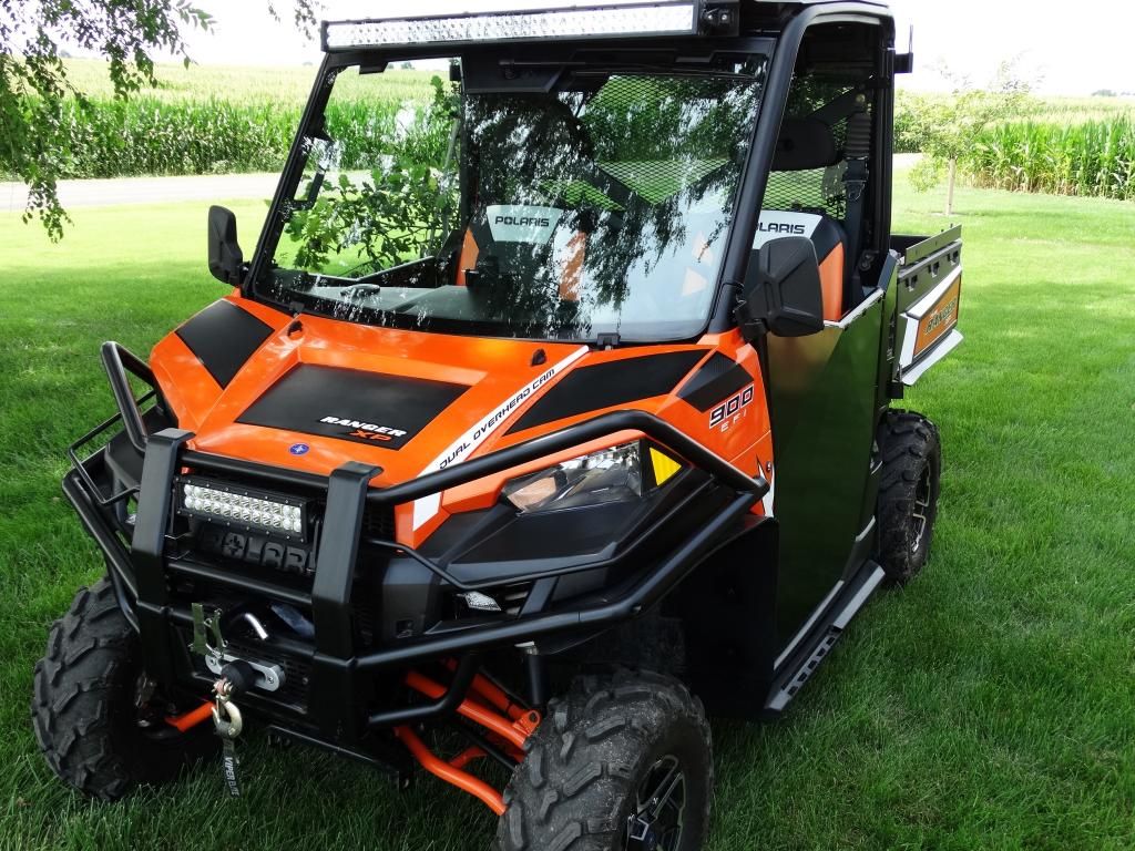

Found this picture on the web as an example as to where I want to mount mine. To me, it looks best here, and would be more protected from low branches as apposed to mounting on top of the roof. Would this location cause light/glare to shine back in my eyes? Would pushing it out an inch or two make a difference? Appreciate any opinions!

I made a sun shade out of 1/8 inch thick by 4 inch wide aluminum and mounted my light right below the roofline. It has no glare for me even pushing snow works awesome. Fictional character Vehicle

I used a piece of 2 x 3 aluminum angle iron and mounted to the under side of the roof. Their is no glare .
