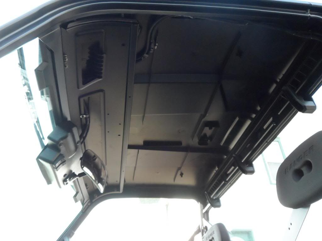

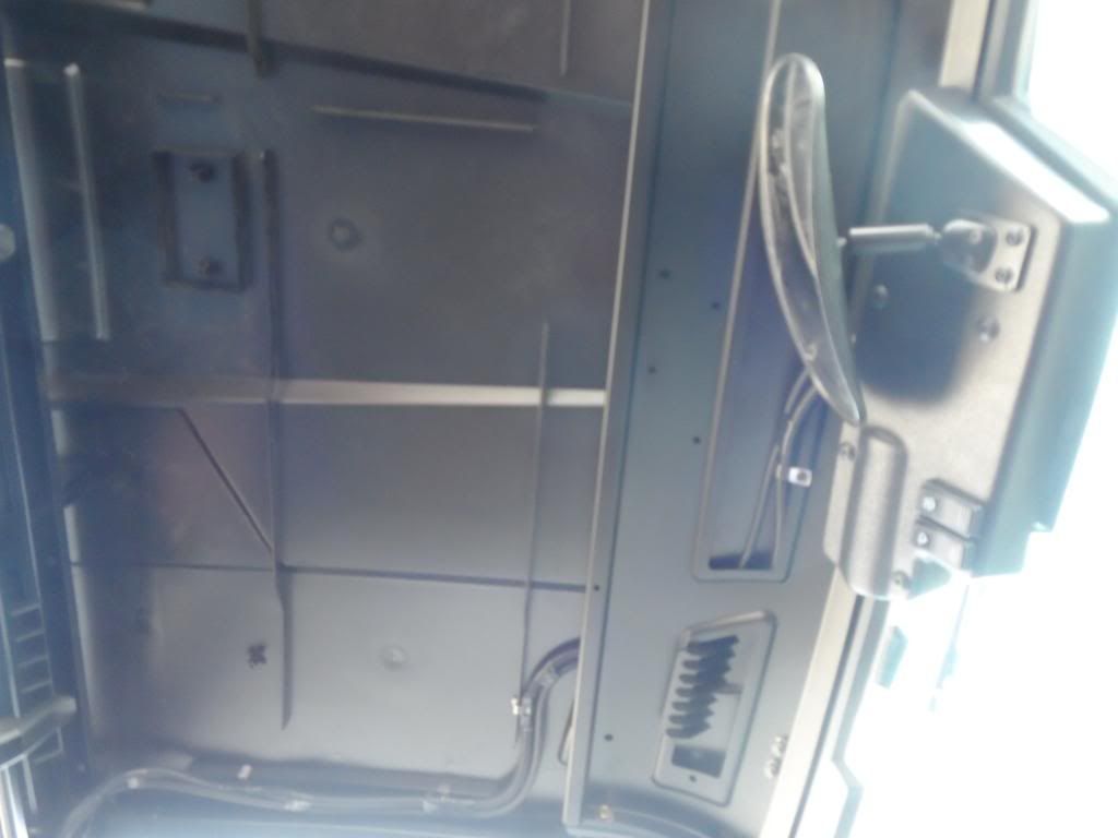

That is the Winshield Wiper Kit there looks good, mine has been backordered for a few weeks. Question for you farmboy where did you get your rearview mirror?
I to would like to know more about your mirror setup.
I want a RV mirror for mine, but that EMP one is a no go with the windshield wiper kit installed... it's nice to see that something exists that does work with it though
Hey Scott. It is a basically a polaris mirror, instead of mounting the bracket that would hold it to the windshield, you would throw the bracket aside and just use the bracket attached to the mirror and find an open area on the wiper contol box and drill new holes that match the diagram of the bracket attached to the mirror, and attach. It holds up real well with no vibration.
Here is the polaris mirror part number ( Pure Polaris Ranger RZR S Rear View Mirror / Pt # 2877945)
