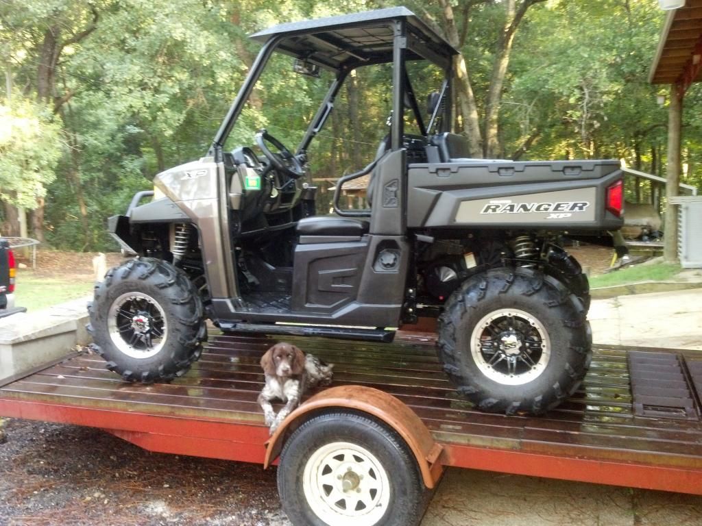

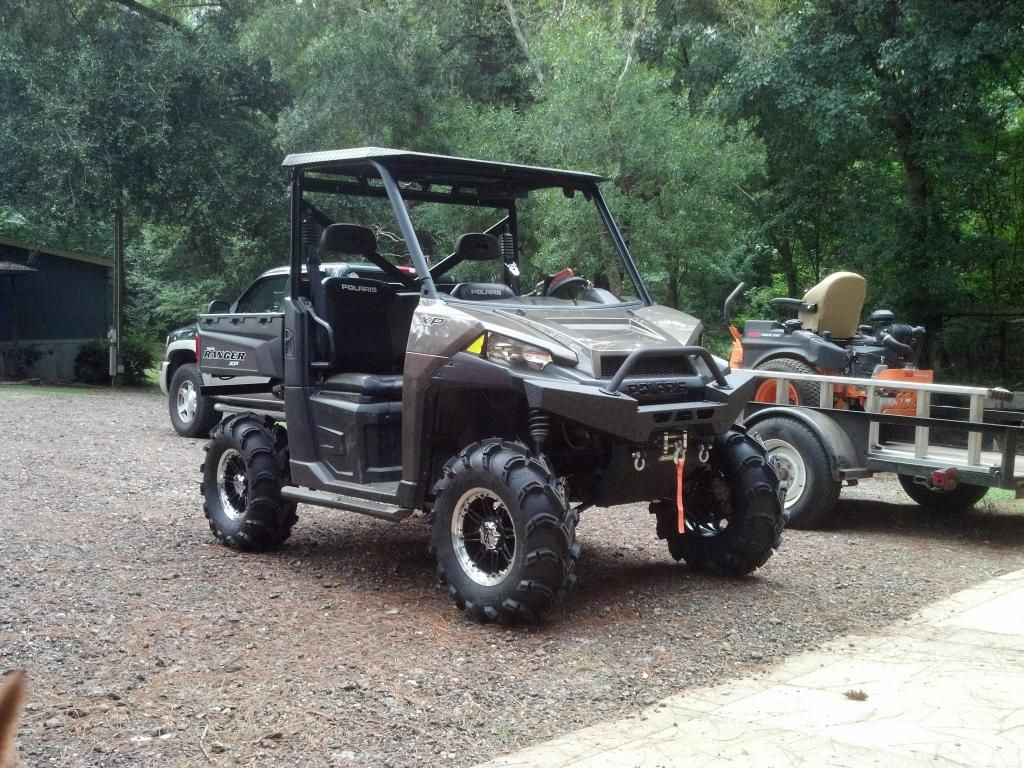

I went through the same process you are going through. My machine runs on all kinds of surfaces, from sandy creeks to serious mud and wet fields down south where I live to the rocky trails of east Tennessee, along with a good bit of asphalt running. I saw one of our forum members was running Super Swamper LTBs and, since I am an old school mud truck guy, I got to thinking why not, they were my favorite tire to run on my old Toyota years ago. Well I let me tell you, I could not be more pleased with my decision! They do GREAT in everything. Sand would be their weak point but still do surprisingly good in that. They may not do as good deep mud as a Terminator, Outlaw or Silverback but they weigh less (my 31s weigh 47 pounds) and I have been able to go anywhere the previously mentioned tires go without worry of a large spinning lug grabbing and breaking something. That gives me a little more room for fun with the skinny pedal too. Now move to hard surfaces of any type and the Swampers will run off and leave them. On my last TN trip, there was 2 brand new Can-ams, one a 1000 Commander with 31" Outlaw 2s and the other a 1000 Maverick with 32" Terminators, Anywhere we could get up to speed I would leave them because those tires are not stable and controllable like the Swampers were on steep, wet rocky trails or on wide loose gravel roads. The Swampers run much smoother on asphalt than my stock PXTs did. After a good 500 miles, lots of them asphalt, they are showing no wear at all. I run beadlocks so I can run 3 to 4 PSI air pressure to overcome the stiff sidewalls and that works like a charm. Others run them on regular rims with more air and still report good results. So in short, do not be afraid to run an LT truck tire, they work.
