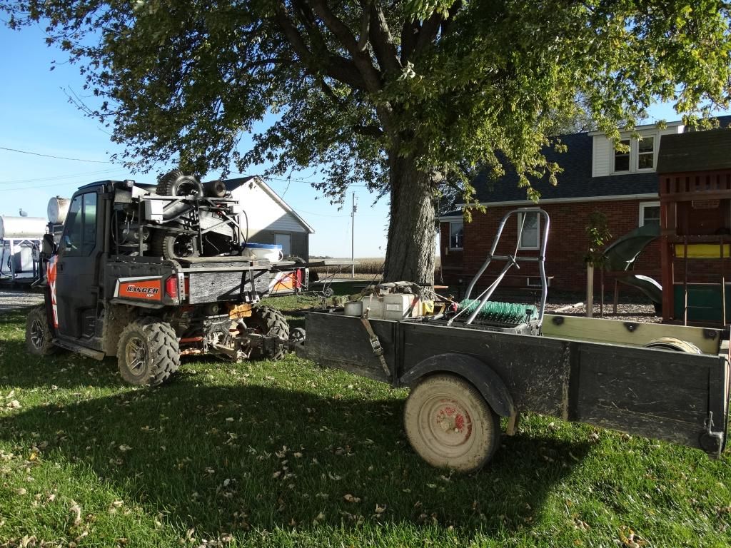

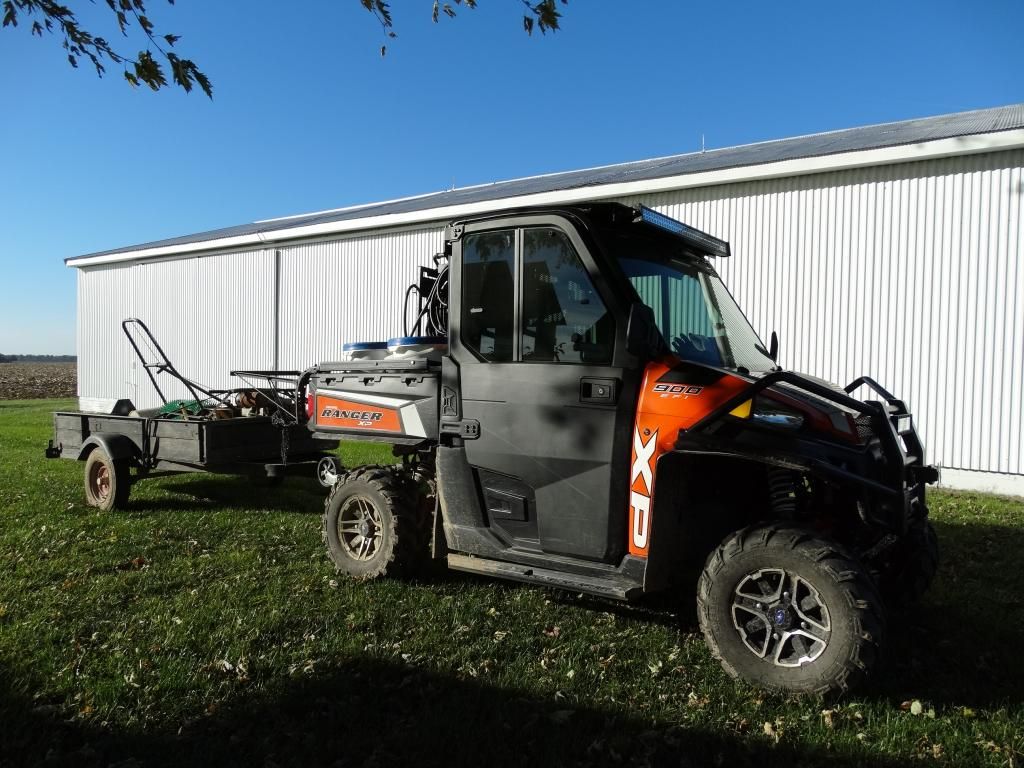

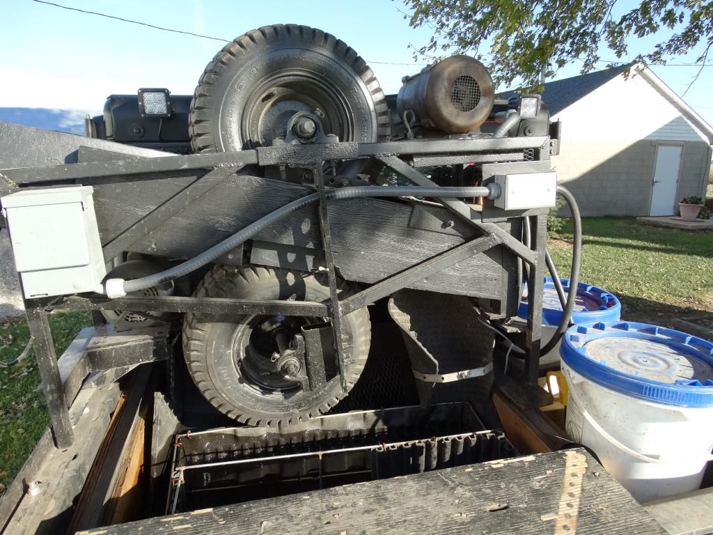

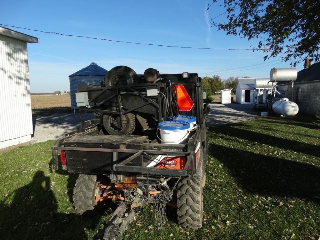

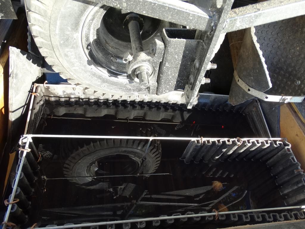

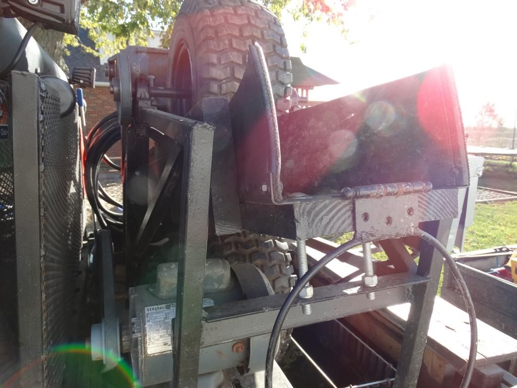

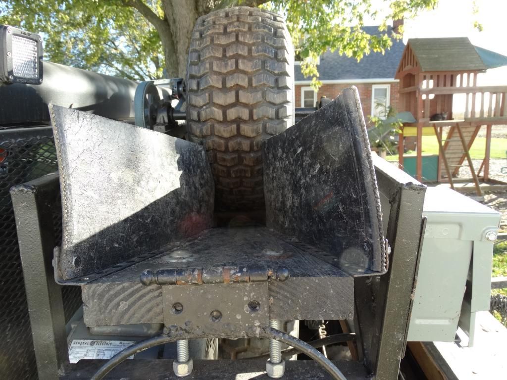

This is what I use to get the hulls off of hickory nuts. It is like a pitching machine for hickory nuts. The wheels compress and shoot the nuts down into the backstop. This knocks the hulls off and they then fall into the water below. I have two treys set up below the back stop. The good nuts sink to the bottom of the first trey and the hulls and bad nuts float which I collect in the second trey and discard. I then can remove the first trey and sort through nuts to check for worm holes. I then can put in a sack for shipment. I use a bucket with the bottom cut out to hold the sack open. I place the sack around the out side of the bucket and into a ring with chains welded on to. The bucket stays in place on the ring and the chains support the sack to hold the weight. There is room for improvement in this system but things are going fairly well.
Thanks for reading!

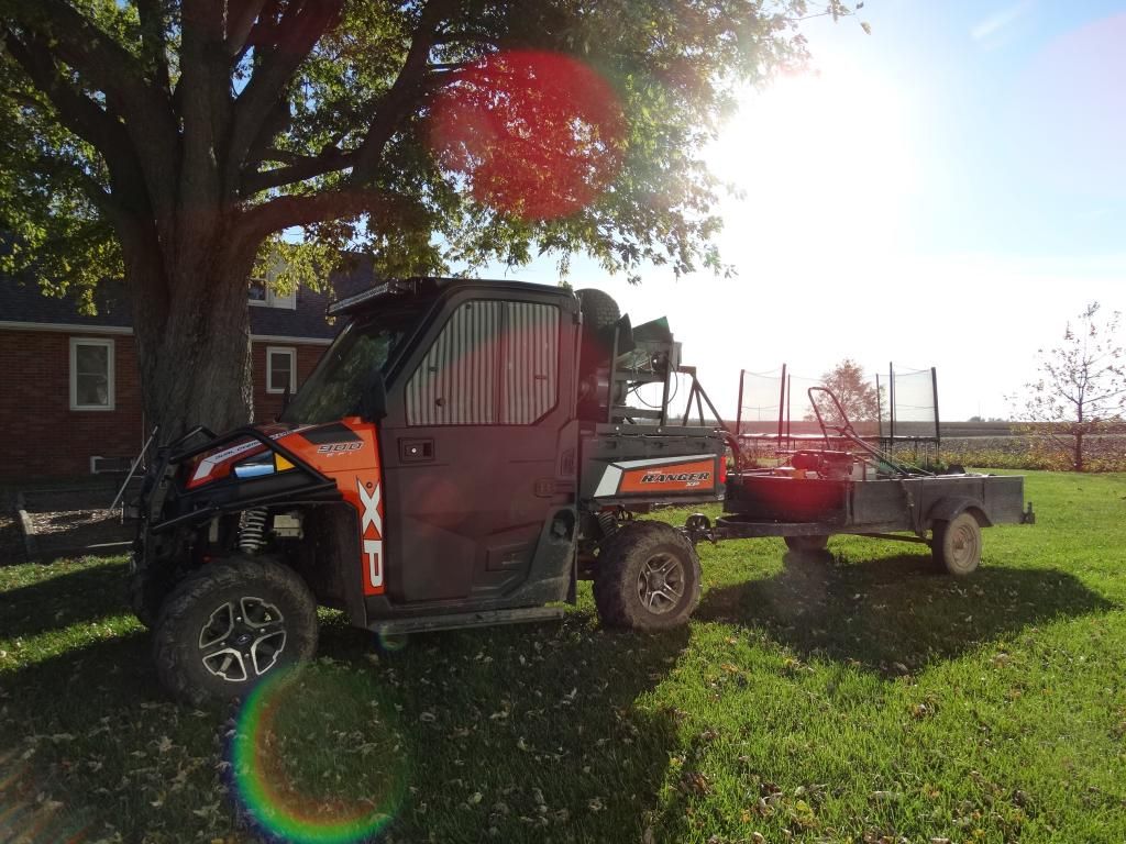

Yes their is Jerry, a large market for shag bark hickory or also known as ( king nut ). My buddy who loaned me his Bag-A-Nut machine (the green thing on the trailer) , is the registered agent for tree seed which covers 5 surrounding states. This means all D.N.R. and tree nurseries go through him for tree seed. Because the shag bark hickory can withstand such extreme weather conditions and flooding it is a perfect choice for the nurseries. He has 5 figure lbs. orders for this year. This is our year that the shag bark bears its nuts in our area. The shag bark bears every other year , so next year your have to drive to another region to find an nuts.
Helping a friend is my main purpose for doing this. The work is hard on me but , I am out in the woods , and that is the plus side. I did make easier on my self and mowed around the tress that I collect under. This allows me to use the Bag-A-Nut machine. That thing is awesome and saves me a ton of time and effort. I like the machine so much that I am going to be a dealer for the company. I have to sell 4 or more machines a year to keep up as a dealer. I am going to buy two machines this year myself.
