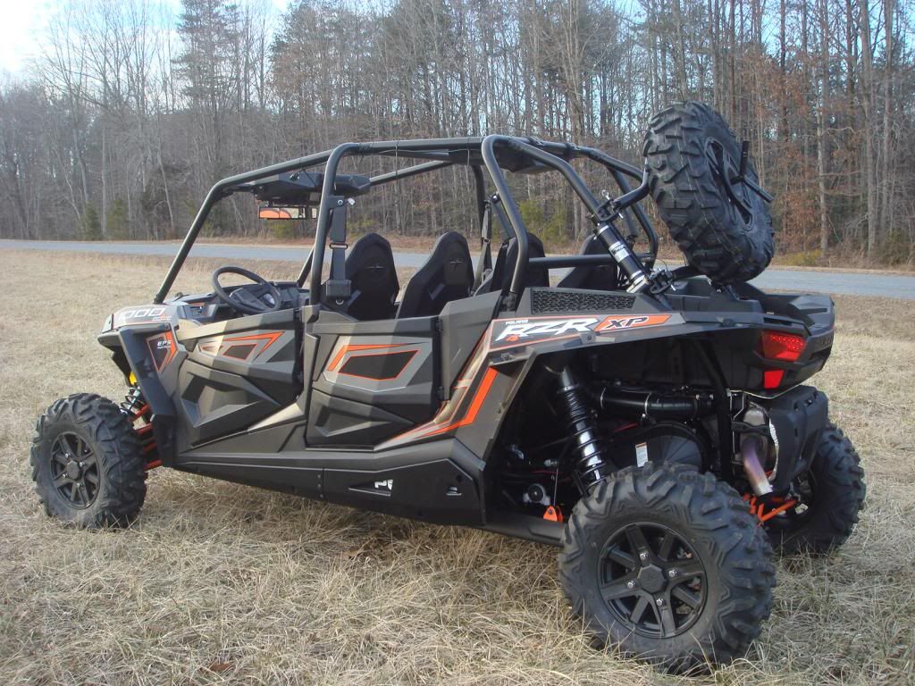

This accessory is a very easy install but does require some persistence in adjusting the fit so it can be opened and shut without too much brute force. I love the look it gives the machine, looks like a Baja buggy going for a race!!! The one disadvantage is the view to the rear is pretty much blocked but hey, that is what they make side mirrors for!!

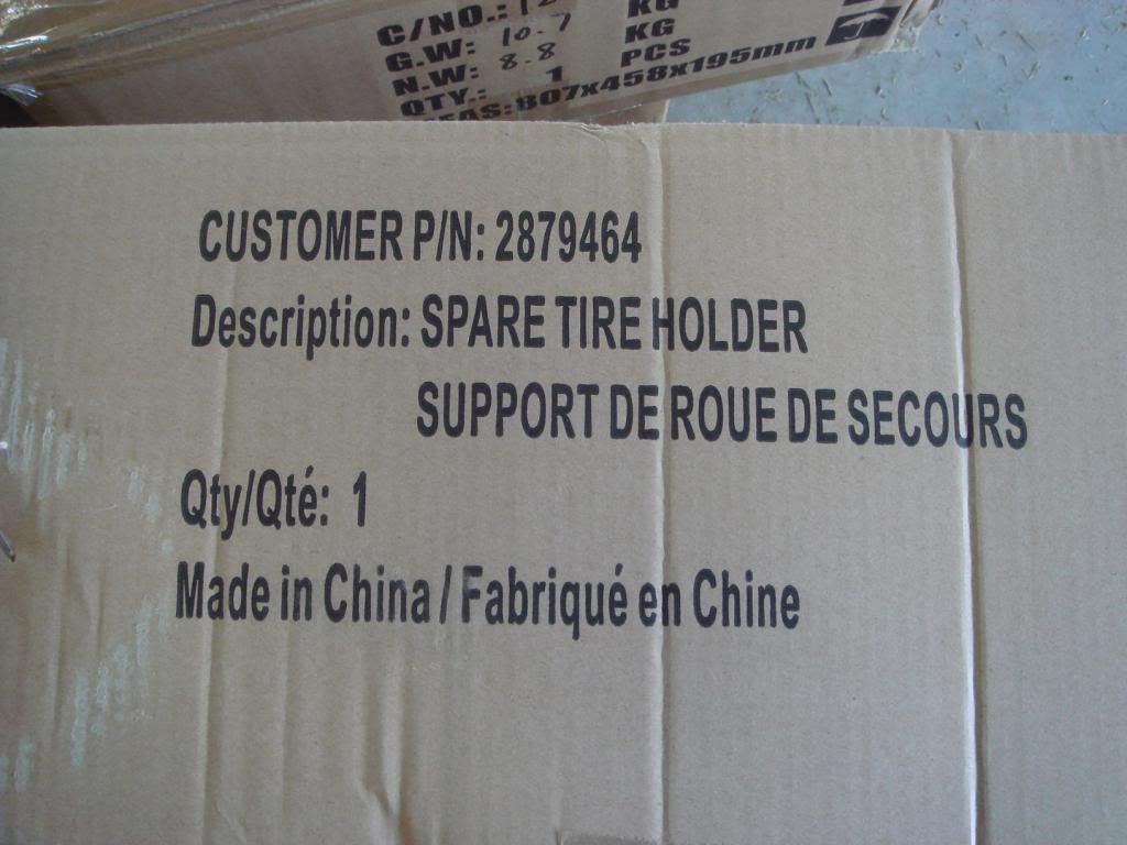

This unit arrived very well packed, I was impressed, and there was no damage. With a unit of this size and weight, it is an accomplishment! The following picture is the product part number, 2879464.

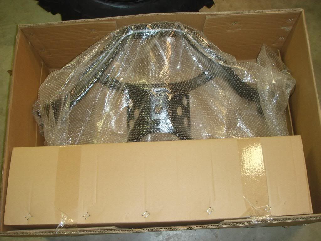

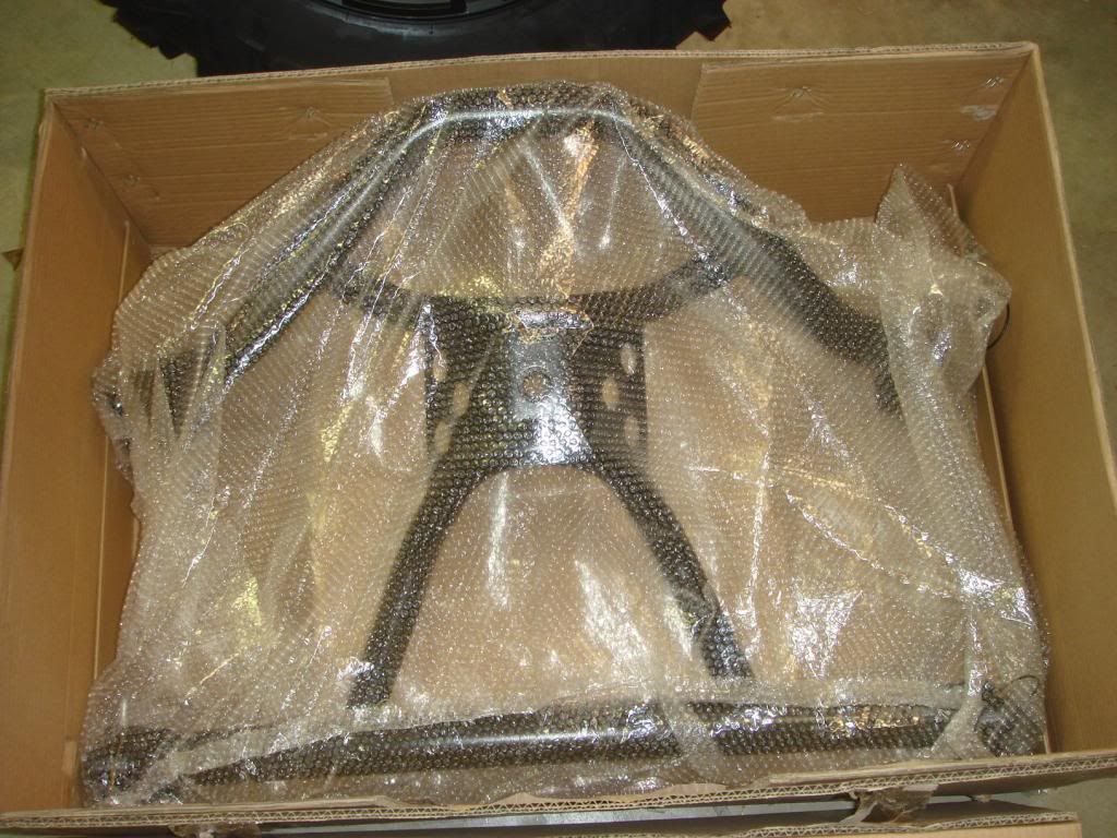

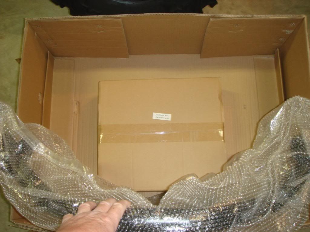

Here are a couple of shots of the packaging. The first one shows the cardboard wedge that was used to hold the unit in place and the second photo is with it removed.

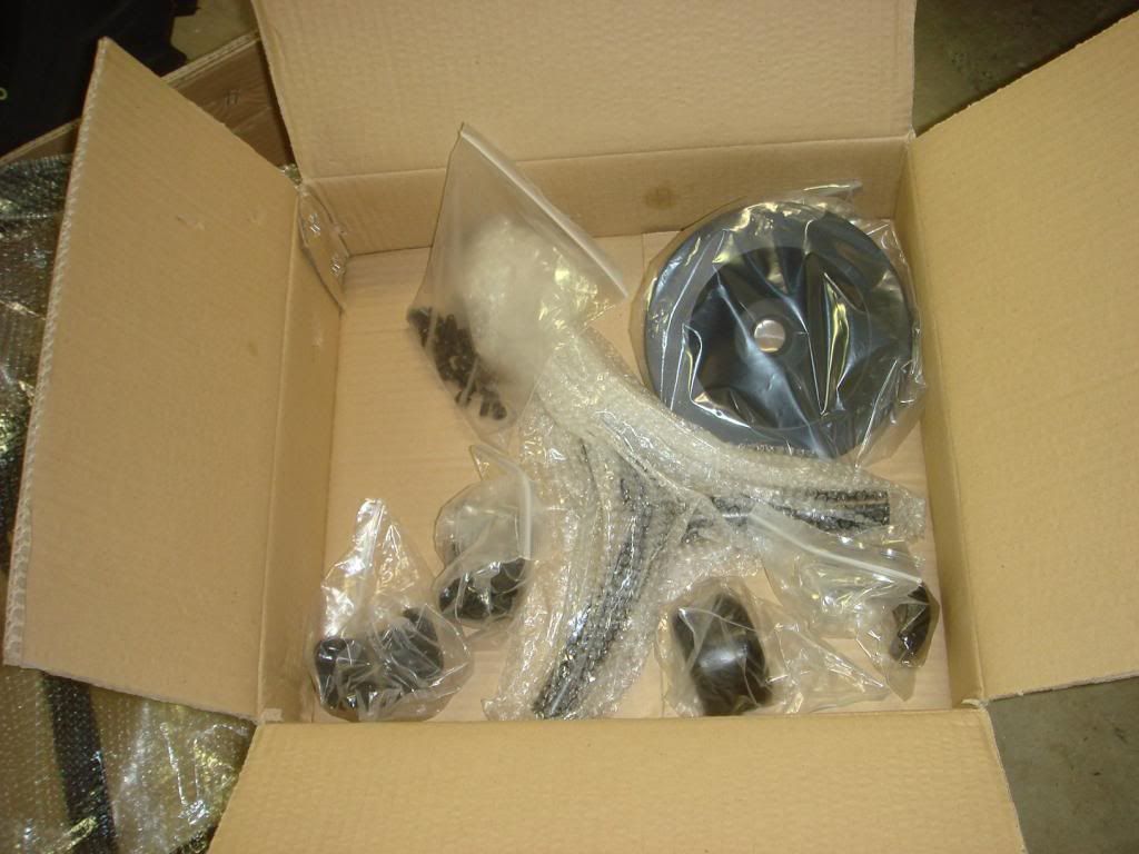

The box of accessories used to mount the holder to the RZR and the tire to the holder are located in a separate box under the tire holder.
These are the contents of that box.

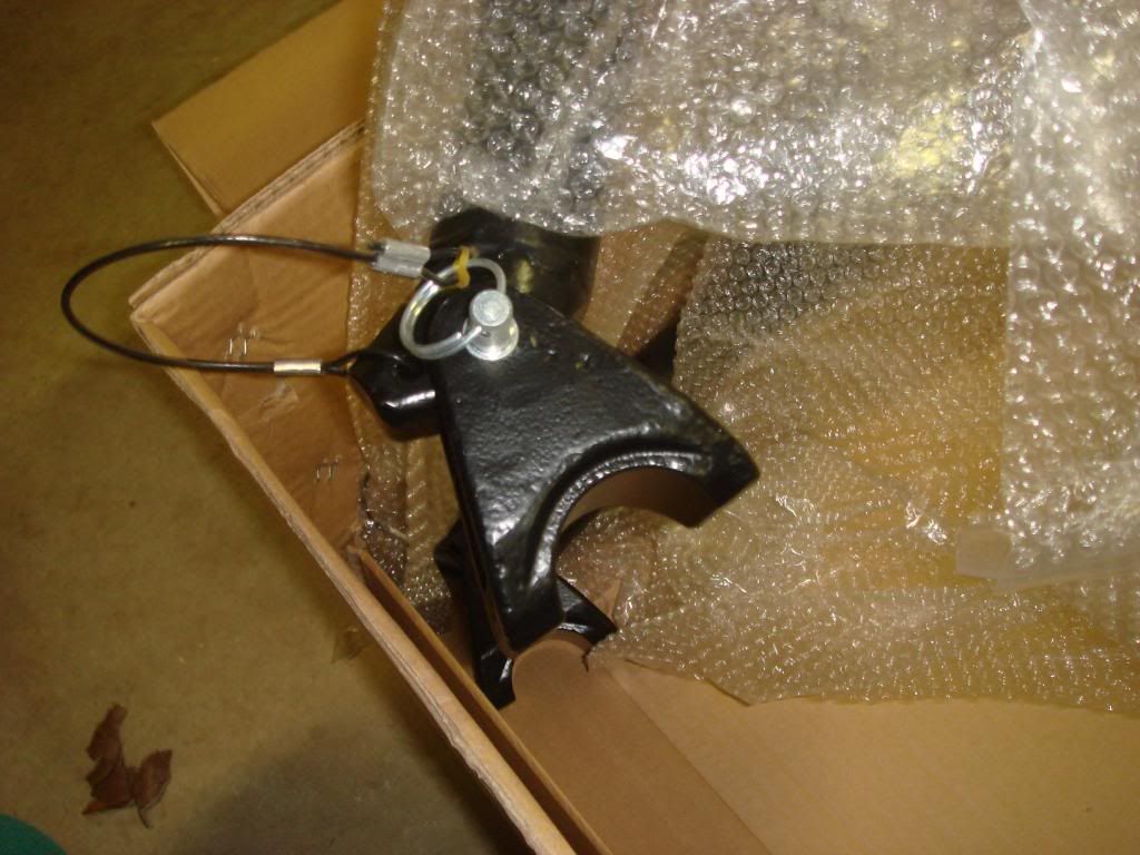

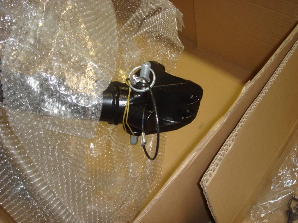

One packaging trick that showed a little thought went into the packaging was the use of rubber bands to hold the quick release pins in place and prevent the ring from damaging the paint if they had simply been left to dangle. It is small things like this that really leave an impression on me and they are cheap and simple.

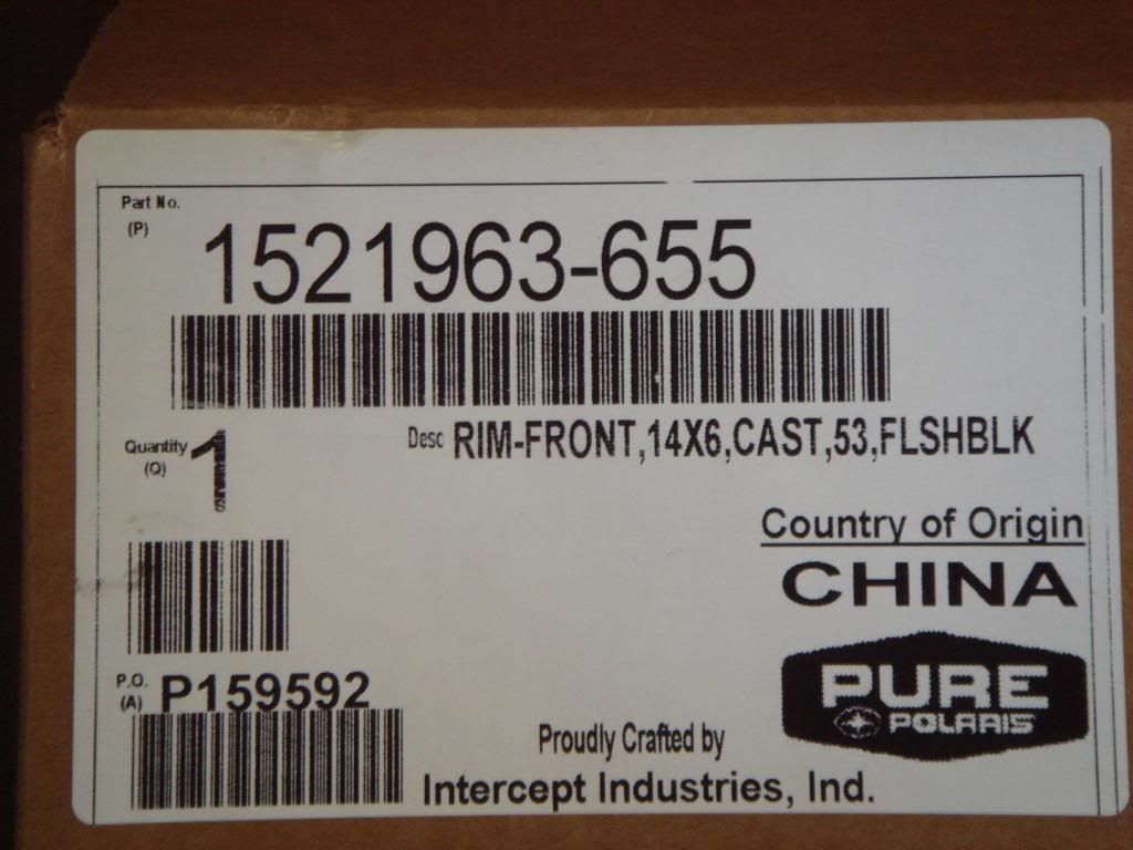

The following is the part number and label information for the stock wheel.

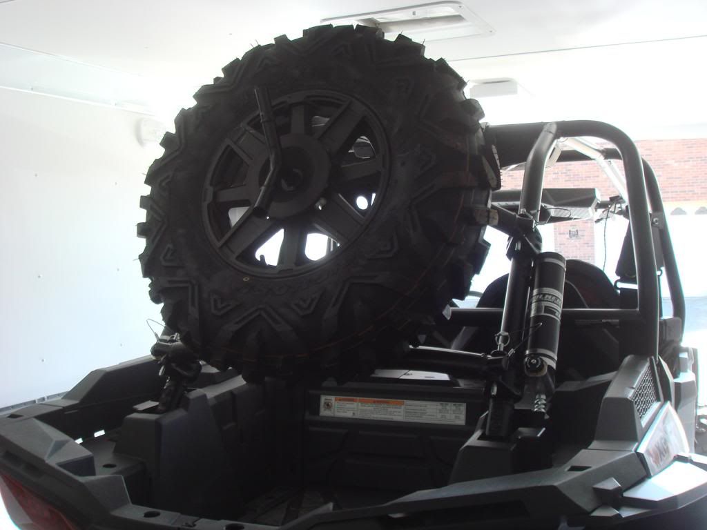

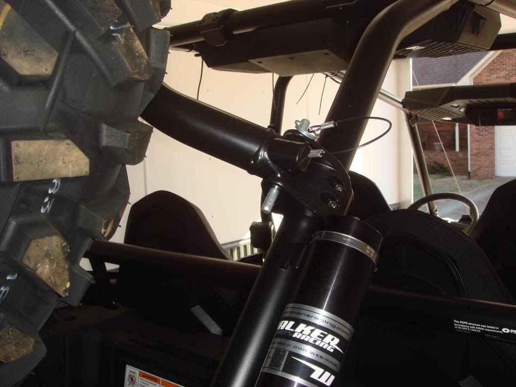

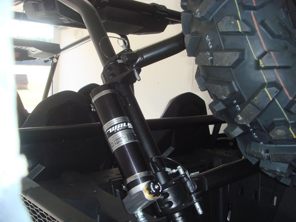

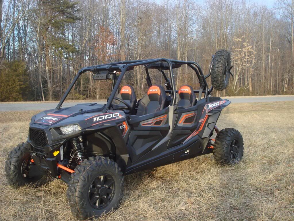

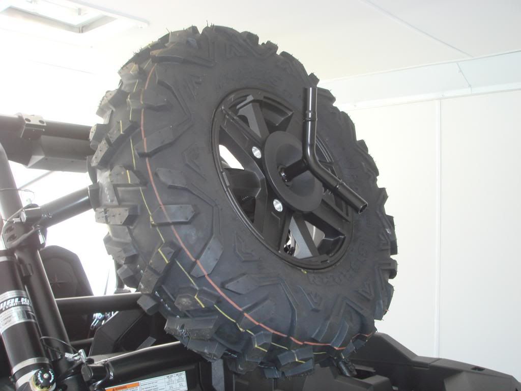

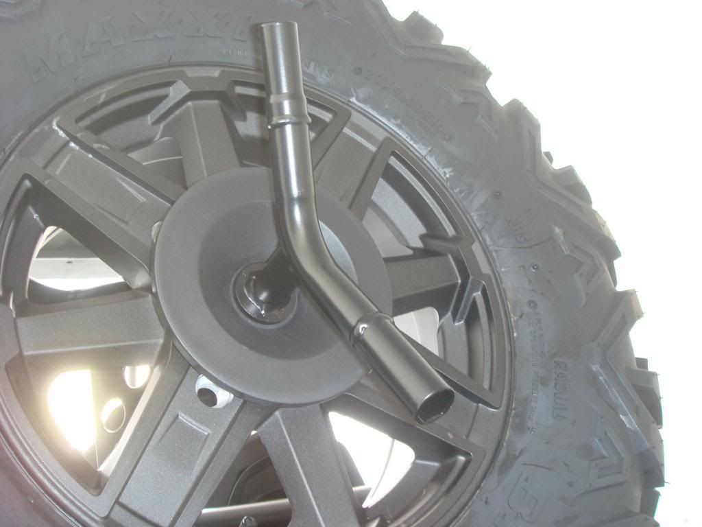

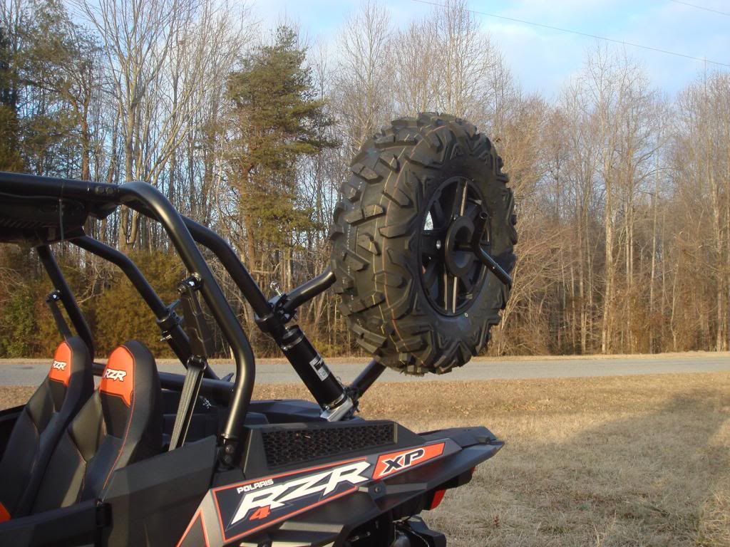

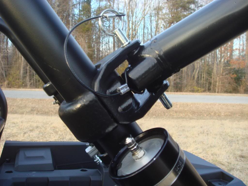

Here are a few shots of the tire holder mounted and wheel/tire mounted to holder. The bottom brackets go just above the weld on the bottom of the roll cage near the bed and then the top brackets are just above the shock remote reservoir. When mounting, leave brackets just snug enough that they can still be moved but not so loose they slide at the least touch. You must align everything so that it opens and closes easily. I found it best to get it close and then fully tighten one side and then work on the other side for final fit. It doesn't matter which side you work with, it swings both ways. This will not be an easy shutting system, more of a slam fit. However, if you leave it a snug fit, it will keep the rattles down. This fitting is the most time consuming part of the installation. Make sure it works well though because once you add the wheel/tire, that extra weight will make an ill fitting tire holder about impossible to open. You really need to be able to open it should you need access to the top of the engine under the bed cover. Another neat thing is that if you go somewhere and just don't want to take the spare, you can remove all 4 pins and remove the holder and wheel/tire without removing the brackets. I really like this and it prevents you having to go through the whole alignment process again.

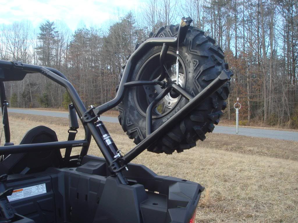

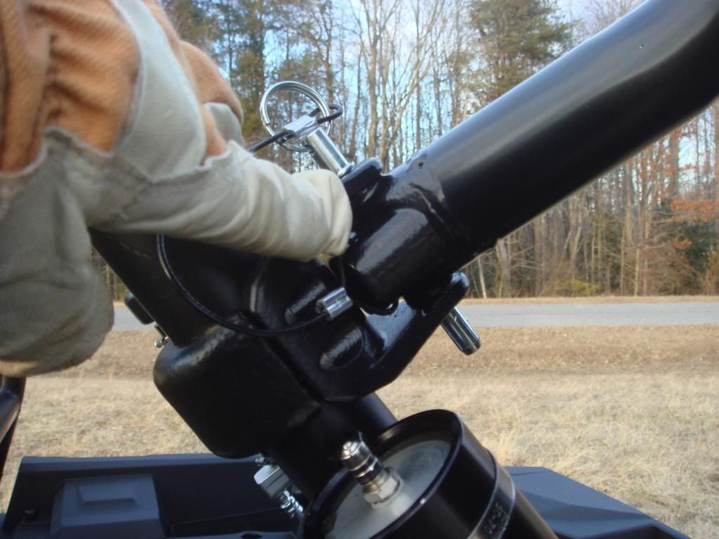

Here are some pictures of the tire carrier that illustrate how you can open the unit in both directions.
Here are a couple of pictures showing the round extension of the carrier that acts as a stop to prevent the unit from swinging out past the side of the vehicle. With the weight of the carrier and wheel/tire combo, this would throw everything out of alignment if it slipped and opened too far. Having these stops, which as part of the carrier are exceptionally strong and will not break, is a very well thought out safety device.

That sure is a robust mount, lloks good too.
18,494 Posts
Nice write-up, Bruce! Dang, that's a good looking machine!!
