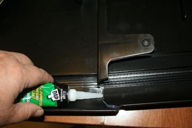

INSTALLATION: I started out by reading through the directions. Then I proceeded by laying the two roof halves on my work
table with the interior side facing up. I started a screw part way on one side of the roof. Then I applied silicone between the halves by lifting the top half slightly. I then started the screw on the opposite side and applied silicone at that location.
I then loosely tightened the rest of the screws and then used an Inch Pound driver to snug the screws down to the 12-15 lbs that is recommended in the directions. ( I personally preferred mine at 15 lbs )
