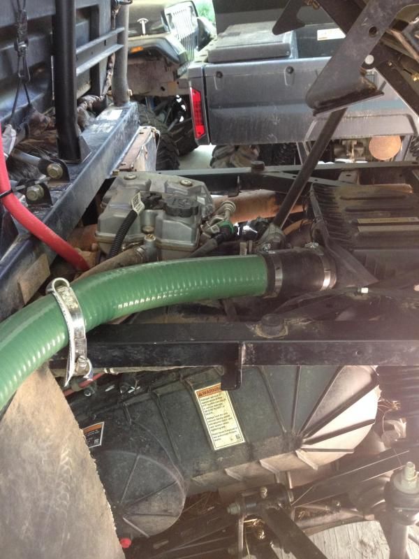

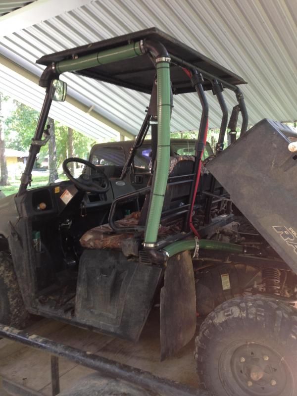

LOL yep it ain't pretty but functional. I work on farms with mine and was having to change or blow out the air filter every few days because of the dust being drawn it from the side. (Poor Polaris design). After the snorkel, I would have about a tsp of dirt on the filter every 2 weeks. I have $60 in it and I can move it in about 10 mins to my future ones since I trade every year. Just bought a 2015 that it's going on...;)

I need the info on that green hose
321 Posts
Looks like 2" pump suction hose!!!!
16 Posts
That's it and the flexible elbows came from Lowes. I didn't have to, but I did trim straight across above the handle on the bed release to make it easier to open and close the bed. The red hose is the crank case vent.
1,084 Posts
Where did u get the pump hose and what size is it and what size are the flexible fittings
16 Posts
Hose is 2" x 8' long that I got at a Case IH dealership, most farm supply stores should have it. Make sure the hose is non collapsible. Fittings were from Lowes and with an ID of 2", might have been a little over 2" can't remember
