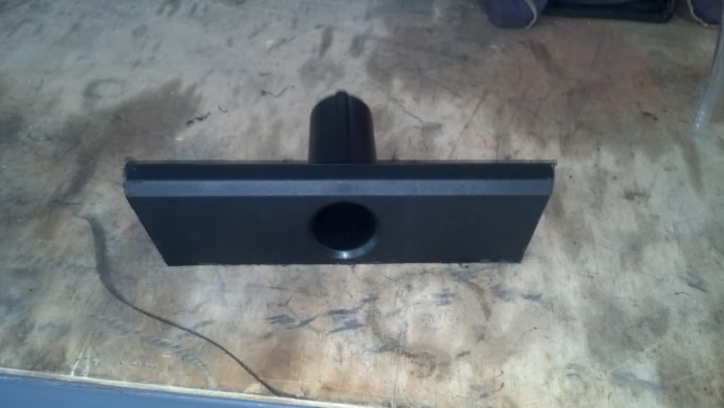

What's wrong with trimming the bed? It dont take away any strength
this is all I had to trim
and then it's reinforced with a steel box

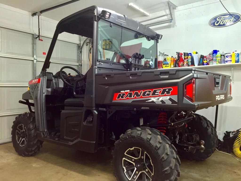

This is the triangle ATV KIT! COMES with a complete install dvd and is an amazing kit!
Reactions: 1
I like the looks of the triangle kit. do they recommend that height, or can I cut them down to not interfere with my sliding window?

Triangle makes an excellent snorkel for the Ranger 900. I was going to do the exact snorkel based on his pics and how clean it looks. When I called them, they did not have a kit for my '15 model. I used the Highlifter kit which is very similar. Cutting the bed was not nearly as bad as people make it out to be, and the amount you trim is minimal.
Does triangle give you a template to mark the cuts?
