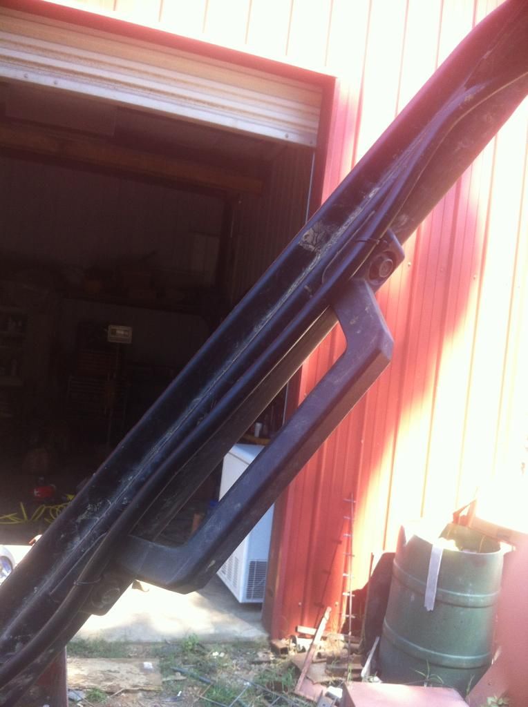

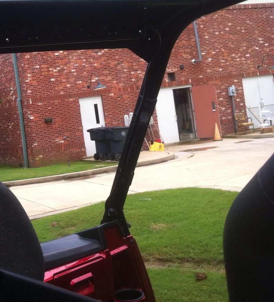

This is what i did with mine. I ran the wire down the rail and took my plastic handle off and drill small holes so i could put zip ties in it to hold the wire. When I got to the dash there is dip next the frame and I notched it out and the wire fit perfectly to go under the dash.

I finally have my Wetsounds Stealth Bar installed. Used some creativity and a lot of help from the forum. Thanks Everyone. I had some 80/20 t slot laying around and painted it black. Also, the wiring harness was able to fit through the dash after I cut a .5 inch notch out. Thanks again for all of the help from the forum!!
