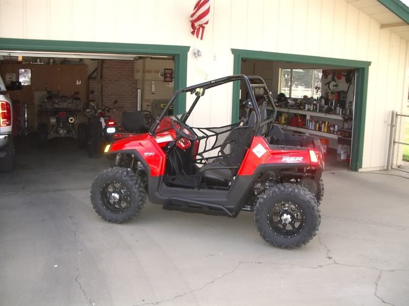

These are 14" ITP SS108 wheels and 26" Bighorns. The right rear rubbed on the motor mount. 1.5" spacers took care of that problem.
An update on rubbing. My dealer told me the right rear rubbed on the motor mount and added the spacers. I was curious today and removed the spacers. They do not rub without the spacers! And you lose the extra 3" of width.
Striperman your nerf bars or on the wrong side. They are supposed to taper up in the back, not down. Wheels look good, what is the width of the machine now?
Stiperman, thats one fine looking ride you've got there and the photo with a description of your goodies is GREAT!

Please spend a moment with a tape measure and post the new overall width...for those of us who feel this is important.
i was thinking those nerf bars were on backwards

<hr height="1" noshade id="quote"></font id="quote"></blockquote id="quote">As a matter of fact the nerf bars were built backwards. You can only install them one way as the front and rear brackets are different. The fabricator welded the brackets opposite of how they should have been. The dealer ordered another pair.
