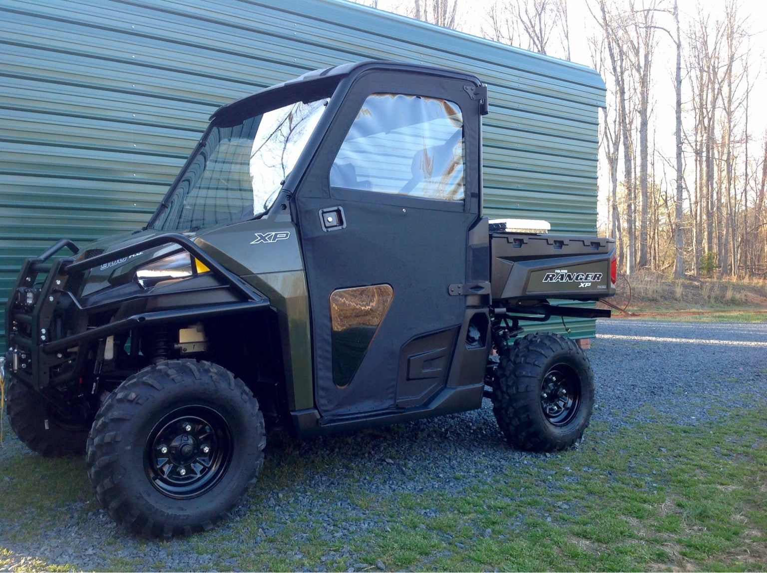

Do you have LED lights on the back of the roof?

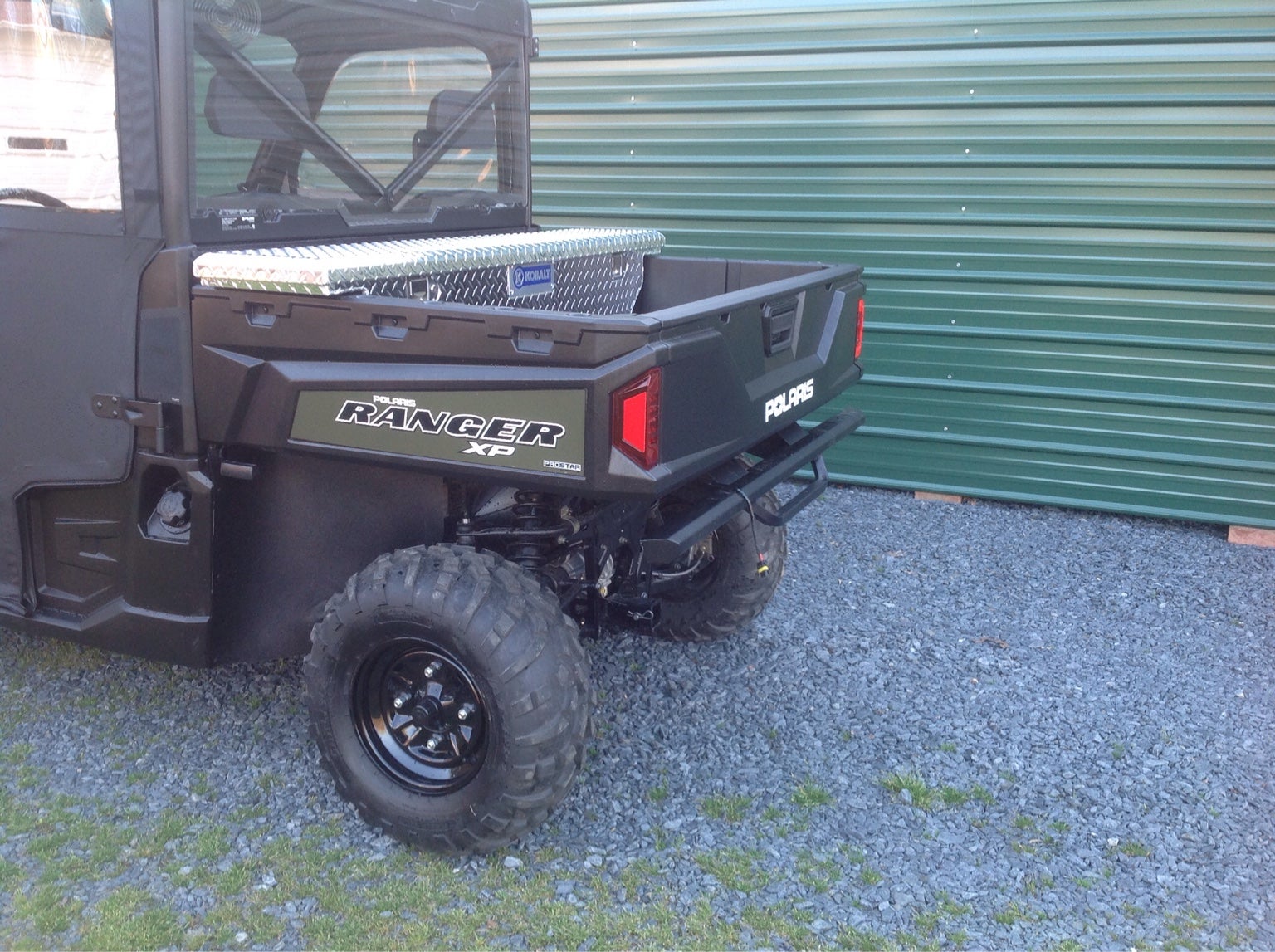

I am about to install a black box from UWS with the lock and ride plugs. It should come in today from ups. I havent seen this box for $160 anywhere, they are around 300 for polished and close to 400 for the black boxes. I sent a 60" low profile box back it did not work. It was 1 inch too deep and the gas shocks interfered with the lock and ride plugs. I have a 58" wide standard profile that should work. Will post pics when completed.
#10 ·
Here you go the 58" width fit perfect.

#14 ·
i really really like my box ... mounted to the floor with 1/4'' bolts and fender washers ... clean fit and all inside the box, not over the rail. the box was intended to sit ontop of a fuel tank.

#24 ·
The low profile 58" box is 11 3/4" tall from bottom of tub to the point of attachment on the bed rails.. The bed of the polaris is sloped with 10 1/2 inch at front where tool box is and is 11 1/2 inch at tail gate.
Also the out to out of the 58" box is actuall 59 with the top included. The polaris bed rails are at 59 1/4 out to out.
The standard profile box is only 9 3/8 deep from bed rails to Bim of tub , so it fits.. You just have to give up the low profile top and get the standard top that is 4 1/4 tall
#23 ·
Hmm that's a 58" box? Looks like it does hang over a bit.... Looks like it hangs out as much as a 61.5" box.
#25 ·
The low profile 58" and 60" box is 11 3/4" tall from bottom of tub to the point of attachment on the bed rails.. The bed of the polaris is sloped with 10 1/2 inch at front where tool box is and is 11 1/2 inch at tail gate.
