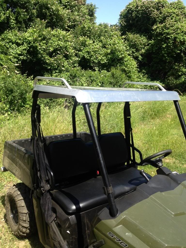

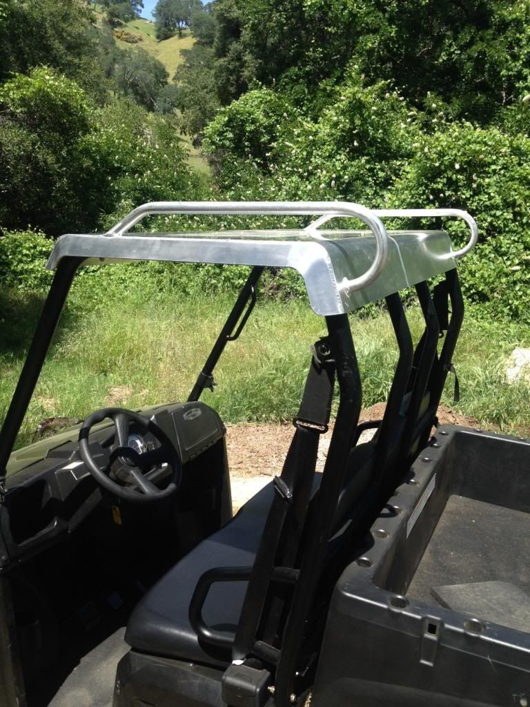

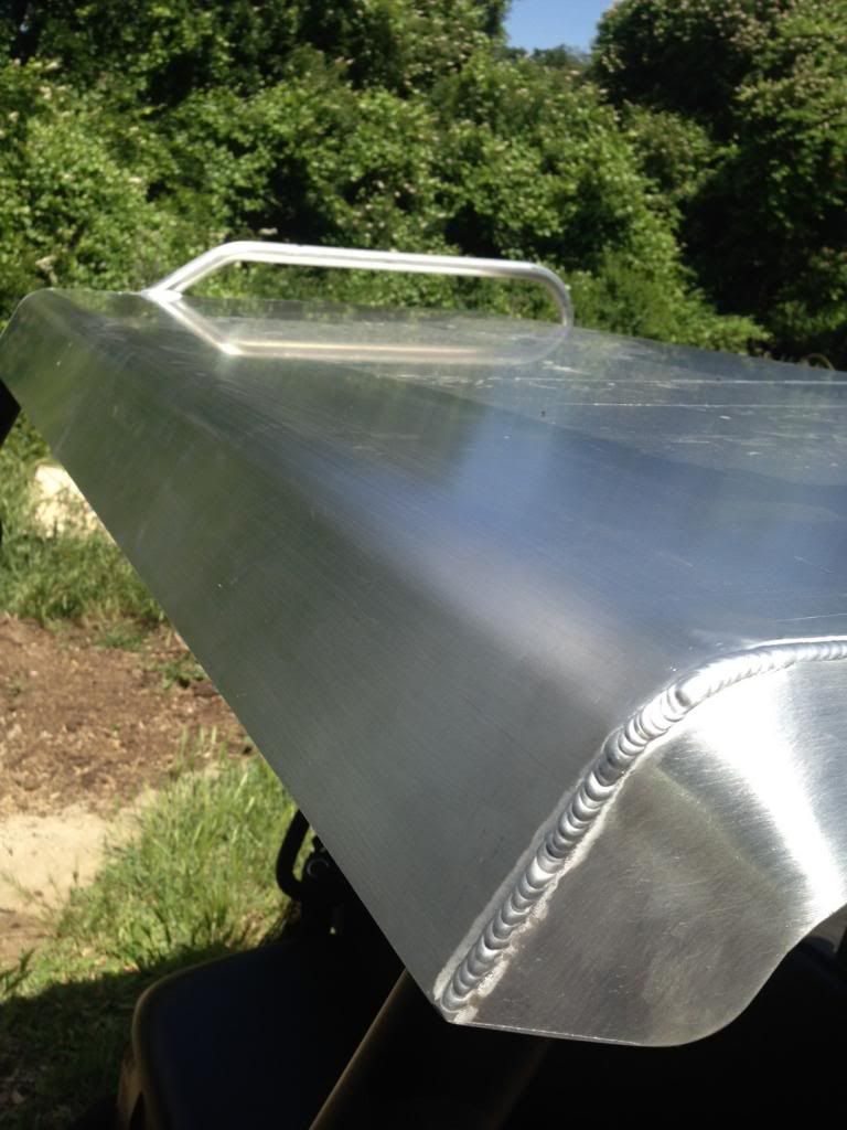

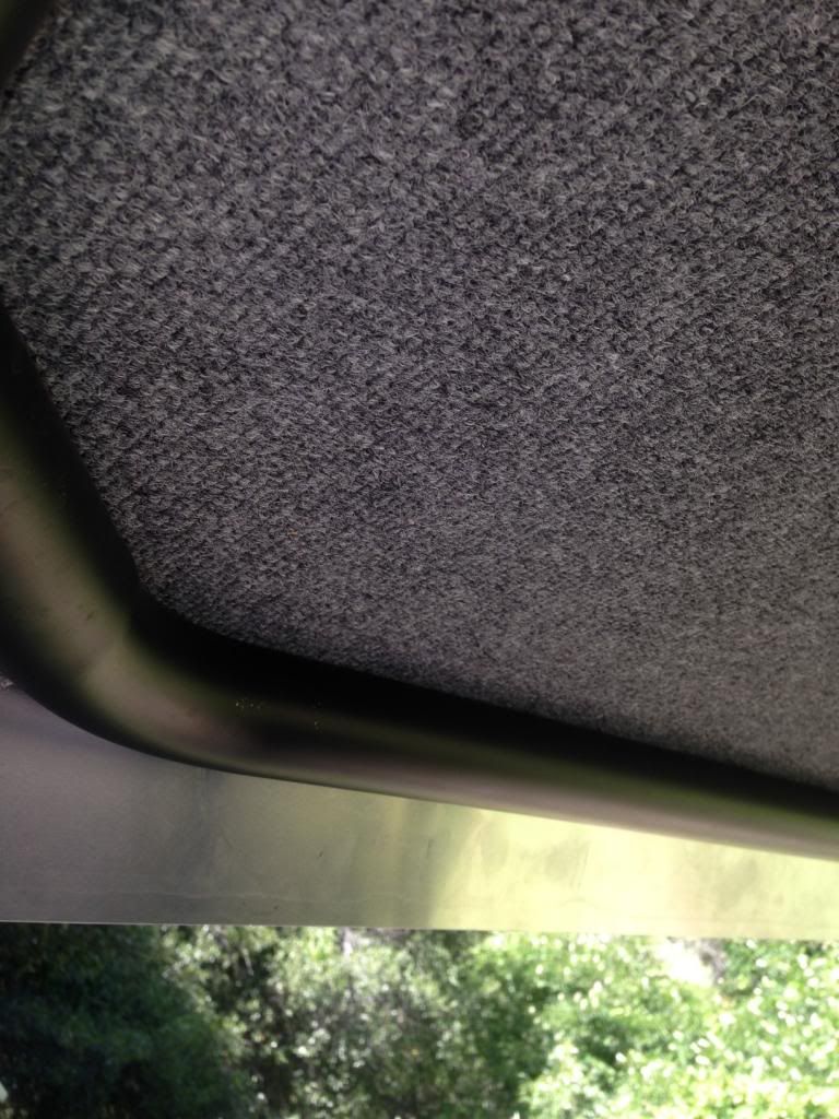

Here's one I did outta 3/16" alum. Added a couple of grab bars spaced 48 1/4" apart so I can fit a sheet of plywood if needed.
Inside carpeted with Indoor/outdoor from Lowe's. Attached with 4 1/4-20 s/s screws through to top/rollbar. The carpet was
needed for sound absorbing, the sound was like riding in a tin garbage can without it.

Dang Jeff , that is awesome! I really like that. You must work in the metal fabrication trade , those are some clean line you have laid down.
