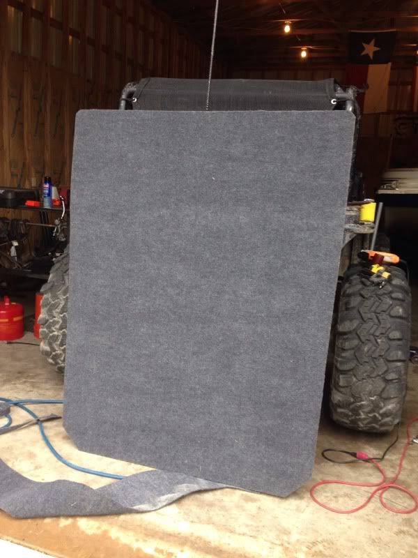

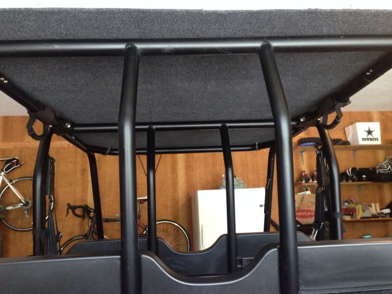

I'm almost done with my roof. I used the McMaster Carr clamps which I thought fit great. The rest of the materials have come from Lowe's:
(2) 3/4" treated plywood.
Indoor/outdoor carpet.
3/4" aluminum trim.
spray on adhesive for carpet.
RTV to seal gaps where the trim was attached. Not that there was a lot but I didn't want water to get in and rot the wood. I will paint it today.

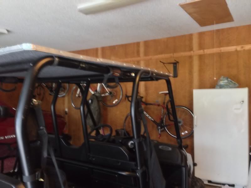

I used 1/8" diamond plate and 1 3/4" edpm cush clamps from grainger part # 1bae2 to attach it to the roll cage its very solid and rattle free

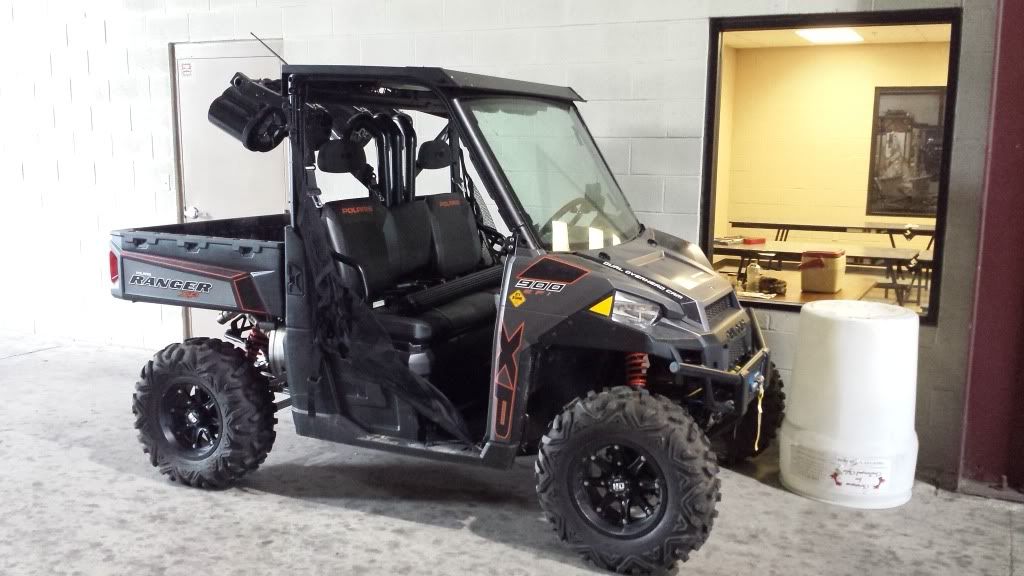

Here is the plywood and angle iron roof I made for my 2012 800 6x6.

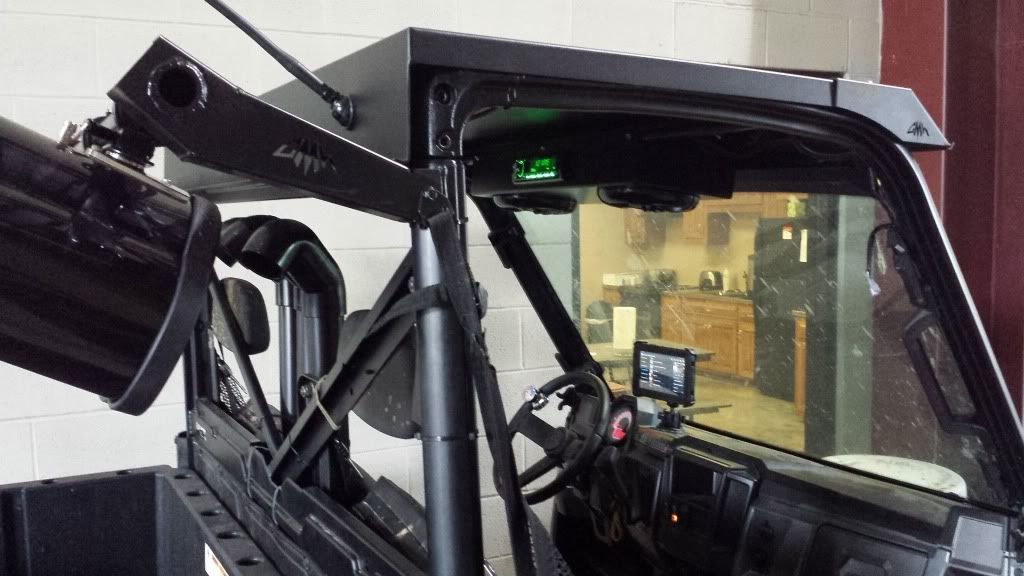

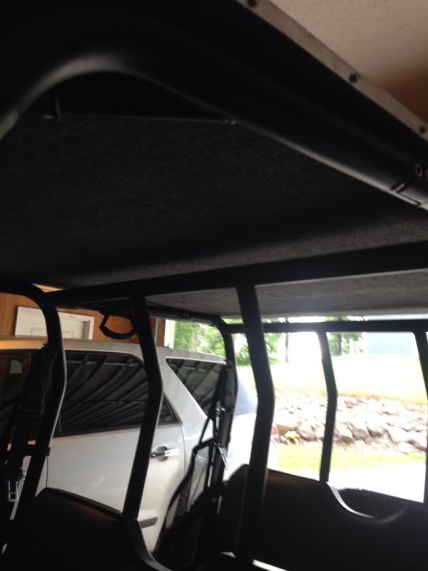

1/8" aluminum diamond plate. I left it polished on top, and painted front, back and inside black. Also installed a headliner.
