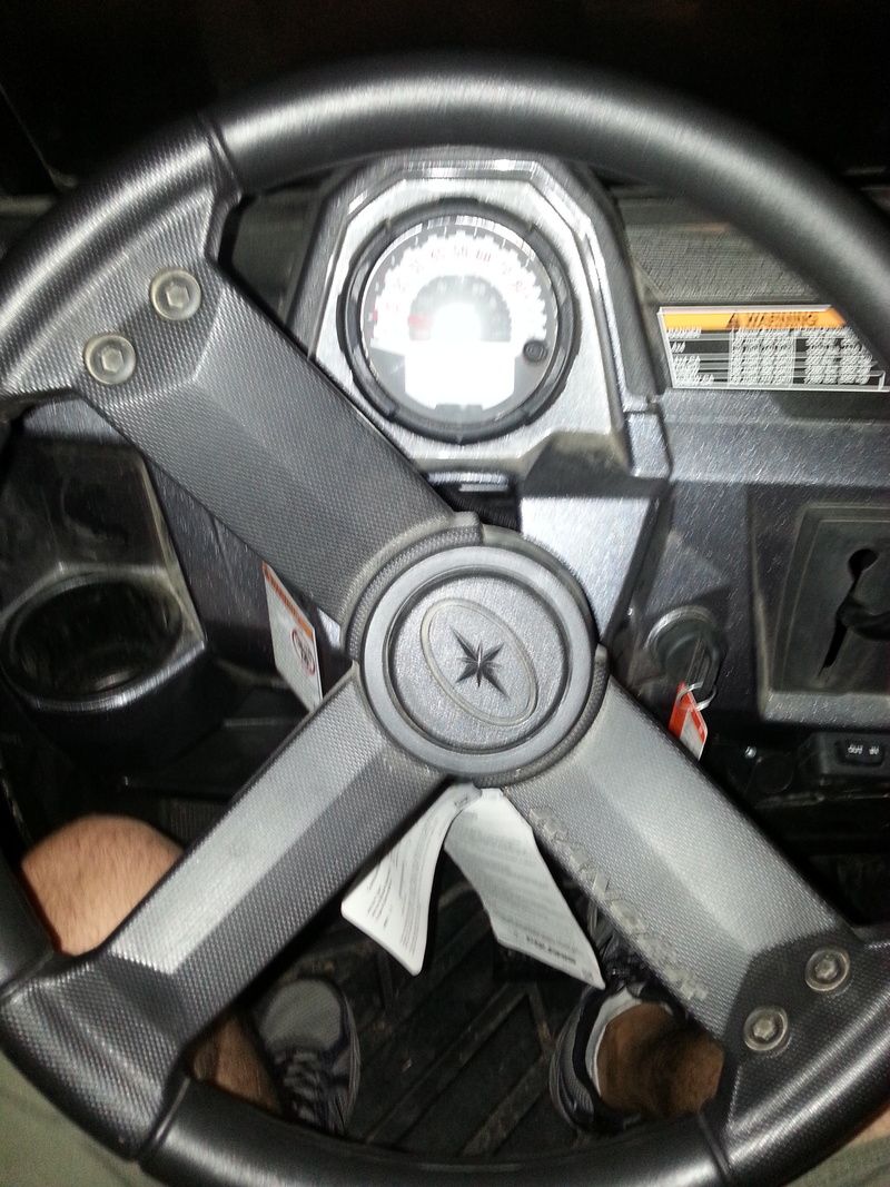

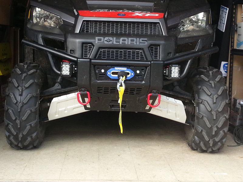

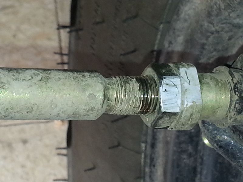

so the dealer "fixed" my steering wheel issue by playing with the tie rods. He said he didnt have a steering wheel puller so couldnt fix it that way. Now the issue i see is that my front tires are not even. Passenger side leans in 3/4" at the top and the driver leans in only a 1/4". the mechanic saw the leaning tires as well. We measured with a tape and level. He took pics and is contacting polaris. Fyi my rear a arms have already been replaced due to excessive camber.

Wel checked the turning radius today and wouldnt you know it...it turns tighter to the right. Turning left takes a full ranger width longer to complete the turn. AND my passenger side a arm guard now rubs the inside of the tire during full turn, hense the tighter turning radius to the right side. So all this happened after the "tie rod fix" of my mis aligned steering wheel. I swear if ots not one thing its another.

Just went through this on my 2020 5oo. Kept busting right side cv boots. Tire rod end were No threads on RF 3/4 in worth on LF. I Lined up factory paint marks on rack. Set toe. Removed and reset steering wheel. My dealer did my alignment wrong after I took unit in for 1st service. It Caused boot failure 3 times.
